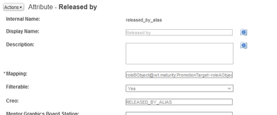

Hi there,
I want to display a "released by" information on my drawing.
I created an alias attribute with this mapping:
roleBObject@wt.maturity.PromotionTarget~roleAObject^wt.maturity.PromotionNotice~primaryBusinessObject@wt.workflow.work.WorkItem~theWorkItemReference@wt.workflow.engine.WfVotingEventAudit~userRef^wt.org.WTPrincipal~name=name@wt.org.WTUser~fullName
The attribute works great so far and lists all User's Full Names, which were involved in the process.
The attribute should be shown as parameter "released_by_alias".
But in Creo no such parameter is listed.
What am I missing?

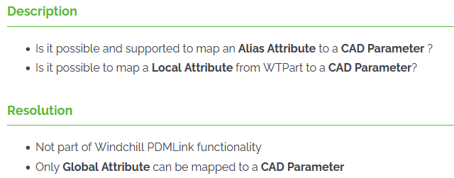

Adding to what @HelesicPetr wrote, see this from CS248702:

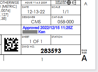

We add released information to our drawings by watermarking the PDFs:
This can be done during publishing using something like LinkAccess Trigger from Fishbowl Solutions, or on-the-fly with something like the PDF Quick Access Starter from Wincom.

No, the picture above was watermarked with LinkAccess Trigger from Fishbowl Solutions,

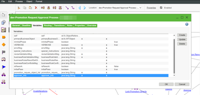

Well, my problem is, that I do not know by detail how to do it.
I get the Approver's name by defining a Variable "approver_info" in the workflow's property page:
And I can query the approver's name by using this expression (either as part of a condition or as a separate "expression block"
//get the principals selected for the APPROVER role
java.util.Enumeration principals_approver=((wt.team.Team)((wt.workflow.engine.WfProcess)self.getObject()).getTeamId().getObject()).getPrincipalTarget(wt.project.Role.toRole("APPROVER"));
while(principals_approver.hasMoreElements())
wt.org.WTPrincipal wtprincipal = ((wt.org.WTPrincipalReference)principals_approver.nextElement()).getPrincipal();
approver_info =  wtprincipal.getPrincipalDisplayIdentifier();
Unfortunately, I have no clue about the last step ( how to "pump" that into EPMDocument ) .

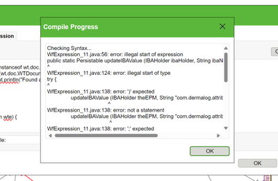

Sorry, Your code does not work inside an expression block within a workflow:
btw, I have used the search engine, schweinchenschlau.
HelesicPetr
(To:Mat)
Hi @Mat
I know. You have to rewrite it that it would work. You have to use full class definitions and so on. Go ahead.
