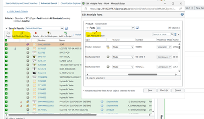

I need to retrieve all the parts from library whose part number start from 9 & update IBA attribute.
Library name: Standard Part Manager
these 3 IBA values need to update
IBA attribute 1: Source - Buy
IBA attribute 2: Assembly mode - Component
IBA attribute 3: Part category - Fastener

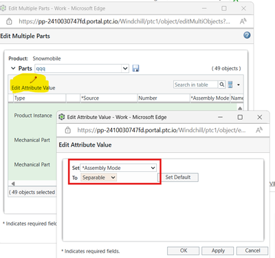

easiest way is to run a search and use edit multiple objects :
select all objects and use edit attribute value :
