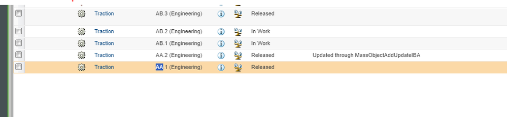

I want to find the previous version of the part which is having version as AA alphabetic
  • July 11, 2024
  • 2 replies
  • 1517 views
Version: Windchill 12.0
Use Case: i was using allversionsfrom(Versioned versioned) to fetch the all versions as to first record version. But for alphabetic version like AA AB im not getting the previous version, please assist
Description:
HelesicPetr
July 11, 2024
Hi @ashiq_097
Please share what configuration do you use for the versioning schema.
What do you expect and what you get. for example, I want the previous version from AB and I do not get AA please describe it more widely
How the code is written? It could help to test it and help you.

hi @HelesicPetr thanks for your response.. we have revision as Double Alphabetic characters as i was trying to use below snippet code to extract the previous released revision details but I'm getting only AB Version in the result.. please assist

HelesicPetr
July 16, 2024
Hi @ashiq_097
The method VersionControlHelper.service.allVersionsFrom(object); returns just the latest objects of all revisions.
So this method can not be used to get non latest version.
if you want to get non latest version then you have to use following method.
QueryResult allVersions = VersionControlHelper.service.allIterationsOf(object.getMaster());
