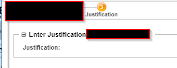

I have a very simple wizard when I just need to gather a text response from the user. I followed an example but must have missed something. My attribute panel appears but not the textbox I had expected. Here is what I see:
Here is the builder code that I used:
public AttributePanelConfig buildAttributesComponentConfig(ComponentParams arg0)
			throws WTException {
		ComponentConfigFactory componentconfigfactory = getComponentConfigFactory();
		AttributePanelConfig attributeconfig = (AttributePanelConfig) componentconfigfactory.newAttributePanelConfig();
		attributeconfig.setComponentType(ComponentType.WIZARD_ATTRIBUTES_TABLE);
		JcaGroupConfig group=(JcaGroupConfig) componentconfigfactory.newGroupConfig();
		group.setId("justification");
		group.setLabel("Enter Justification");
		group.setIsGridLayout(true);
		JcaAttributeConfig attribute = (JcaAttributeConfig)componentconfigfactory.newAttributeConfig();
		attribute.setId("justification_value");
		attribute.setRequired(true);
		attribute.setLabel("Justification");
		attribute.setComponentMode(ComponentMode.EDIT);
		group.addComponent(attribute);
		attributeconfig.addComponent(group);
		return attributeconfig;
I thought that all I needed was to set the component mode to edit. I did this before with a table but in that case I used a data utility to make a editable text box. Is that what I need to do here? This should just be a simple textbox where the user can enter a short few sentences and I can pass that to a workflow.

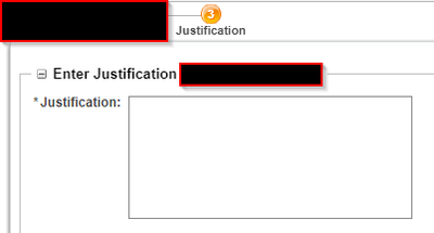

And here is the final result:
To retrieve the text from the textarea, I was able tie my shoes all by myself!
//find Justification
String justification="No Justification provided";
l.debug("Checking input for a justification");
l.debug("Bean Count:"+list.size());
for(ObjectBean bean:list)
	l.debug("checking bean " + bean.toString());
	if (bean.getChangedTextArea() == null)
		l.debug("no changed text area in this bean");
		continue;
	l.debug("Found a changed text area");
	Map<String,String> textAreas=bean.getChangedTextArea();
	l.debug("Map size:"+textAreas.size());
	l.debug("found justification");
        justification=textAreas.get("Justification");
        //found justification
        break;
