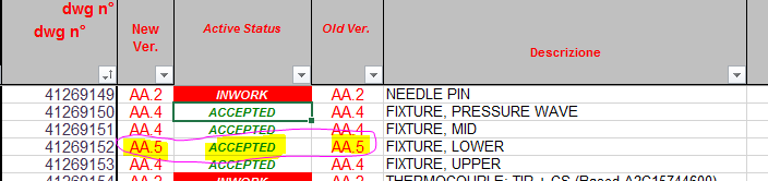

I have a Little excel database, and I would like to read the "Status" and the "Version+Iteration" of drawing.Little Database
Also the description, maintaining some kind of Read-Only link from Windchill, I suppose that somethiing like DTI "DEsktop integration"  that do an OOTB from office applications, but is possible to do ?
@Marco_Tosin shared link if for the document itself ( not data inside ) right ?
IMO Desktop integration cannot do that.
@mbuonfiglioli you need to make a report
Report can be exploited directly or linked as data source in excel.

Hi Vincent,
yes, as you wrote, DTI cannot make a list like the image from Excel file.
You could link attribute from a Windchill WTDocument and put it in his Primary Content, using DTI.
To obtain something like in Excel image you have to use a query builder report as source.
@mbuonfiglioli
Here you can find lots of report ready to use and some useful advises on how to work with query builder.
Marco
