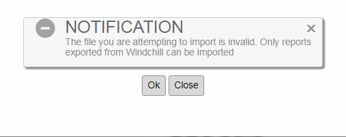

Thanks Vincent. Having trouble loading it.
We are on 11, M020
Vincent-Kulak
(To:lgrant)
I have re-exported as zip ( 11 M030 )
