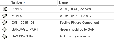

The View to BOM Type mapping I do not believe was needed in my setup but didn't hurt things. So, it should split this into two separate files but now I need to ensure that the Design BOM does not get exported. Why you might ask? Well, let's say that the Design view has parts on it from CAD that are not something you want created in SAP as a Material Masters. They are garbage more or less. Like this Design BOM:
I do not want GARBAGE_PART to appear in SAP. At the same time, I want components of BOMS to appear in the file so we can create those to BOMs have what they need. In my case, I could not see a path forward for the folks in SAP to distinguish.

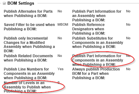

My setup for the "Design" view DT was as follows. I am not sure which preference did the trick but if you know, let me know:
So, this should go down 0 levels and not publish data on components of Design BOMs. This prevents my GARBAGE_PART from appearing in the XML file for creation as a Material Master. Note: The BOM for the Design View still did appear in the XML file. But since I instructed them to ignore Design View BOMs, its ok.
