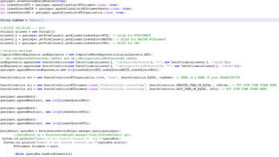

Hello @NG_9451104
build a Query Specification is tricky.
Sometimes you have to use a some workaround to get you really need.
You have to define a relation between tables. In this case it is from WDocument to WTDocumentMaster and then to WTOrganization
As I know there are some limitations if you want to define direct Column names you should define aliases to get right column information from database
(or error is presented Example: Attribute "masterReference" is not a member of class "class wt.doc.WTDocument")
Following query spec should work for you.
QuerySpec queryspec;
queryspec = new QuerySpec();
queryspec.setAdvancedQueryEnabled(true);
int indexObjectWTD = queryspec.appendClassList(WTDocument.class, true);
int indexObjectMASTR = queryspec.appendClassList(WTDocumentMaster.class, true);
int indexObjectORG = queryspec.appendClassList(WTOrganization.class, true);
String orgName = "AVENG";
//alisID (A0,A1,A2 ... atc)
String[] aliases = new String[3];
aliases[0] = queryspec.getFromClause().getAliasAt(indexObjectWTD); // alias for WTDOCUMENT
aliases[1] = queryspec.getFromClause().getAliasAt(indexObjectMASTR); // ALIAS for MASTER WTDOcument
aliases[2] = queryspec.getFromClause().getAliasAt(indexObjectORG); // ALIAS for ORG
//relation settings
CompositeWhereExpression andExpression = new CompositeWhereExpression(LogicalOperator.AND);
// (A0.idA3masterReference=A1.idA2A2) and (A1.idA3organizationReference=A2.idA2A2)
andExpression.append(new SearchCondition(new TableColumn(aliases[0], "idA3masterReference"), "=", new TableColumn(aliases[1], "idA2A2")));
andExpression.append(new SearchCondition(new TableColumn(aliases[1], "idA3organizationReference"), "=", new TableColumn(aliases[2], "idA2A2")));
queryspec.appendWhere(andExpression,new int[]{indexObjectWTD,indexObjectMASTR,indexObjectORG});
SearchCondition sc0 = new SearchCondition(WTOrganization.class, "name", SearchCondition.EQUAL, orgName); // HERE is a NAME of your ORGANIZATION
SearchCondition sc1 = new SearchCondition(WTDocument.class,"thePersistInfo.createStamp", SearchCondition.GREATER_THAN_OR_EQUAL , newTimeStamp); // PUT YOUR TIME STAMP HERE
SearchCondition sc2 = new SearchCondition(WTDocument.class,"thePersistInfo.createStamp", SearchCondition.LESS_THAN_OR_EQUAL, newTimeStamp2); // PUT YOUR TIME STAMP HERE
queryspec.appendAnd();
queryspec.appendWhere(sc0, new int[]{indexObjectORG});
queryspec.appendWhere(sc1, new int[]{indexObjectWTD});
queryspec.appendWhere(sc2, new int[]{indexObjectWTD});
QueryResult queryRes = PersistenceServerHelper.manager.query(queryspec);
Hope this can help
PetrH

Hi
Sorry for the delay,
I've tried your suggestion but I can't get the objects count, for the same date if I search in UI there is an object available. Maybe I missed something. and let you know
HelesicPetr
(To:NG_9451104)
Hi @NG_9451104
Try to use Like for OrgName instead of equal.
PetrH
HelesicPetr
(To:NG_9451104)
Hi @NG_9451104
I guess the time format could case wrong results.
How do you create Timestamp object?
I see an output with just date not time.
If I use following definition for timestamp it gives me correct results. (all documents :D)
Timestamp newTimeStamp = new Timestamp(Long.parseLong("0"));
Timestamp newTimeStamp2 = new Timestamp(System.currentTimeMillis());
PetrH
Hi HelesicPetr,
Sorry for the delay just stuck in some other projects now i have tried these lines but it is not works for me maybe i missed something,
Now I tried the same using webject and it is now working fine, Thanks for the support and once again sorry for the delay.
