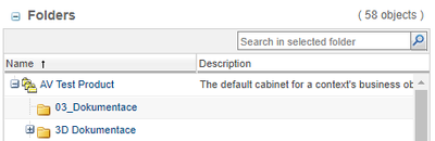

Good day
I would like to add another column in the Folders table (left pane) not the Folder Contents table (Right pane)
Currently the only column is "name" and i can only sort by name.
I need a description column that displays the description of the folder.
See attached picture
HelesicPetr
(To:Markh74)
Hi @Markh74
You can rewrite OOTB java class to add the description. After restart you can see the Description in the Folder tree
I just added two rows to the code
var5 = this.getComponentConfigFactory().newColumnConfig("description", "Description", false);
var3.addComponent(var5);
class folder place
WindchillFolder\codebase\com\ptc\windchill\enterprise\folder\mvc\builders
Windchill 12.0.2.3

Do not forget to backup original class file
