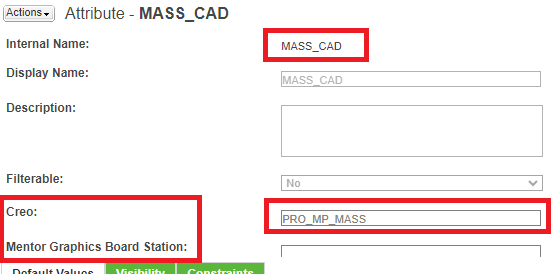

I just add that you can define the mapping in the type and attribute management for IBA attribute.
you can define a attribute that is used in the Creo/NX/Catia/others that is populated to the EPMDocument attribute in Windchill
Here is an example for MASS_CAD that is populated from Creo PRO_MP_MASS
