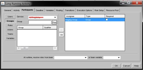

I have a workflow task which is assigned to a WTGroup. When the task is alive, users get added and removed to the group. The workflow tasks which are alive does not reflect any changes made to the group, I tried modifying the wf team and it works only for new tasks not the already existing ones, reassignment through API works but this is not a reassignment so I do not want to use that option. Any thoughts on an API which I can do to refresh the existing tasks? Thanks in Advance.

This did not help either. There is no role resolution through LC. It is actually the WF activity which i want to refresh

Thank you for the reply.  augumentrole API didn't update the tasks assignment, I am wondering this is because the task is assigned to the group instead of a role
Thanks Bhushan.
I changed from Activitiy Participants mapped directly to group  to Activity Participants mapped to a role to a group.
After that the wt.team.TeamHelper.service.augmentRoles(object, wt.team.TeamReference.newTeamReference(wt.team.TeamHelper.service.getTeam(Obj))) method updated the participants.
