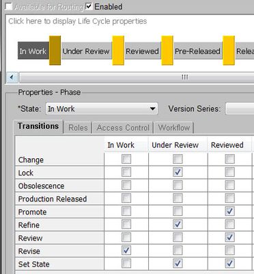

The easiest option would be to define the lock state and use the Method  transitionTargets(Object theObject, Transition transition, boolean failIfNoTransitionExists) to set the affected objects to a lock state defined by LC template. But I am not sure, whether this work for CR, I have used this for CN.

For that to work, each object type we manage (wtPart, EPMdocument, etc.) would need to have lock selected at In Work ?

BineshKumar1
(To:lgrant)
That's correct. But I am not sure whether lock method works for Change Request. It works for change notice, change task or even promotion request.
The code which had in my previous post will work without any lock transition
BineshKumar1
(To:lgrant)
Since the "lock" method is well-proven over many releases for Promotion, would definitely be best to utilize that approach if at all possible.

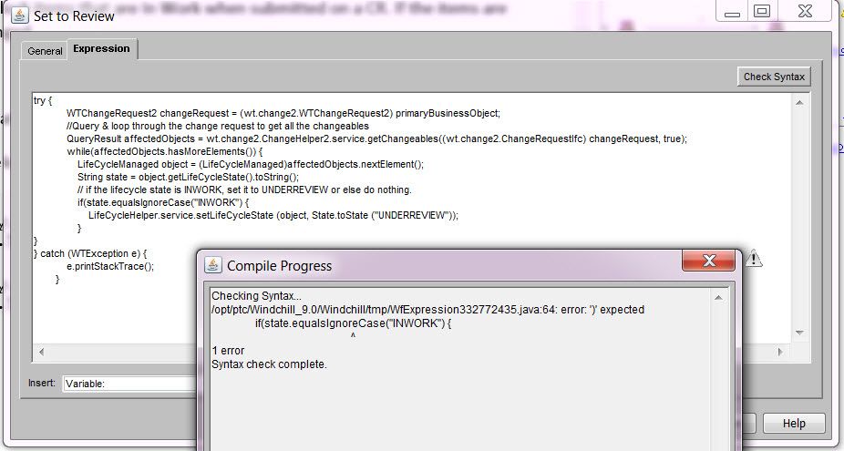

lgrant
(To:BineshKumar1)
Any idea what the error is?
RandyJones
20-Turquoise
(To:lgrant)
You are missing a closing ')'
if(state.equalsIgnoreCase("INWORK")) <---------
lgrant
(To:RandyJones)
After adding in the missing )
I now have a new list of errros.
Checking Syntax...
/opt/ptc/Windchill_9.0/Windchill/tmp/WfExpression332772435.java:59: error: cannot find symbol
QueryResult affectedObjects = wt.change2.ChangeHelper2.service.getChangeables((wt.change2.ChangeRequestIfc) changeRequest, true);
symbol: class QueryResult
location: class WfExpression332772435
/opt/ptc/Windchill_9.0/Windchill/tmp/WfExpression332772435.java:61: error: cannot find symbol
LifeCycleManaged object = (LifeCycleManaged)affectedObjects.nextElement();
symbol: class LifeCycleManaged
/opt/ptc/Windchill_9.0/Windchill/tmp/WfExpression332772435.java:65: error: cannot find symbol
LifeCycleHelper.service.setLifeCycleState (object, State.toState ("UNDERREVIEW"));
symbol: variable State
/opt/ptc/Windchill_9.0/Windchill/tmp/WfExpression332772435.java:65: error: package LifeCycleHelper does not exist
/opt/ptc/Windchill_9.0/Windchill/tmp/WfExpression332772435.java:68: error: cannot find symbol
} catch (WTException e) {
symbol: class WTException
Note: /opt/ptc/Windchill_9.0/Windchill/tmp/WfExpression332772435.java uses unchecked or unsafe operations.
Note: Recompile with -Xlint:unchecked for details.
6 errors
Syntax check complete.
