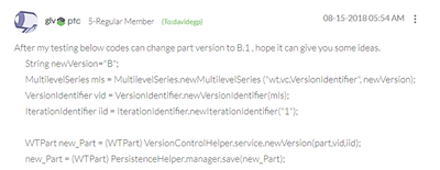

Hi
Need API for revising WTPart subtype.
Need to revise and set the revision to a later revision.
Tried using below.
But this does not works for revising WTPart Subtype with custom revision scheme.
Anyone if tried ,please share the code.
Thanks.
