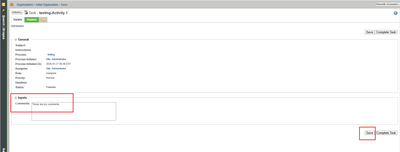

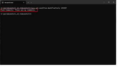

Is this what you're looking for.
I created a test workflow and entered a value in the comments field.  I then hit the "Save" button.
Next, I ran code that prints out the saved comment as it is stored in the dB table/column.

Hi @d_graham,
Have you used the following API to retrieve the comments?
WorkItem workItem= new WorkItem();
workItem.getContext().getTaskComments();
