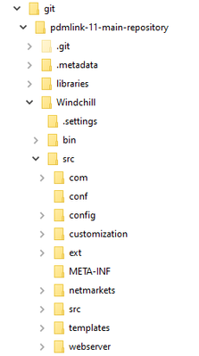

Curious about your GIT integration. It seems like your Dev environments have Windchill loaded. How much of that do you manage in GIT? Is it just source or are you managing compiled classes to? Here is an example of mine. I've tried to be religious about linking Jira issues to commits in BitBucket. I think I need to amend my steps to pull from repository not from local compiled classes in Eclipse. I can see potential for error here or at least create a separate build environment. Just might be too much overhead for my small operation.

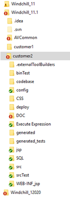

Hi @avillanueva
I use SVN.
In my case I have different folder structure which follows customers then Windchill structure.
In SVN I keep just java source.
I only keep Classes in a package committed in SVN which are deployed on production server.
