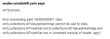

I created one action in the windchill UI, if we click on that action it will collect all the cad Assemblies which is associated to WTPart from the structure and the collected cad assemblies  will be added to the workspace, from that workspace I wanted to checkout and  checkin the cad assemblies from the workspace.i am able to do checkout but checkin is not happening, its throwing error.
This is code that i written for the checkout and checkin.

HelesicPetr
(To:RaikarRaghu)
Hi @RaikarRaghu
Soo resolve the error.
The error points you where your code has an issue.
So in your case you use some function that expects WTKeyedHashSet but you provide WTValuedMap
So you need to find the row in your code and correct it.
