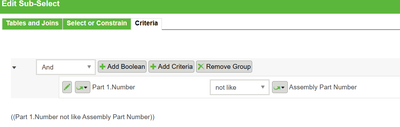

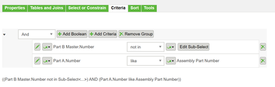

You could do this in Query Builder, with some more advanced criteria.
You would need to add a criteria that the Part B Master Number is NOT in a Subselect.

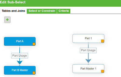

The subselect would be Assemblies using Parts, with the additional criteria that the assembly's number is NOT Part A's number
So in English: Return all the part numbers in this assembly that are NOT in any other assembly
I'd recommend using a Parameter to enter the Assembly's Part Number for performance reasons. That would look like this:
You would need more criteria, but here's what you're missing:

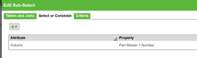

And here's the sub-select:
This is referring back to the same parameter as before:
