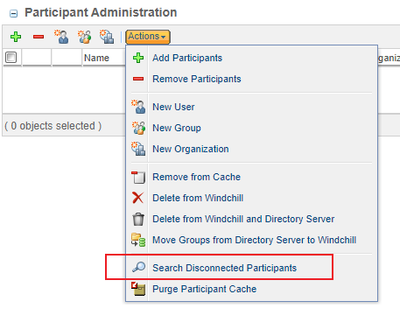

I don't see any similar records in the knowledge base...
Do you want to try "old user has been disconnected and reconnected to a new username" This seems to meet your requirements, but there are no similar records in the knowledge base either
If you are testing, why not give it a try
Y.Driouchy
(To:Rocket_Max)
that's the safest way to do it , all taken care by Windchill participant management tool.
otherwise, WTUser is the key table , if you know what i mean and up to the risks 😉
