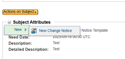

I am not looking to create the Change Notice Automatically, I receive this task to create the change notice and there is an action to do so.
But the specific task do not have the complete button, because of the wrong activity template. I cannot set it from the UI because it I need to check for certain validations on start  of the activity. Let me know if you need more clarity on it.

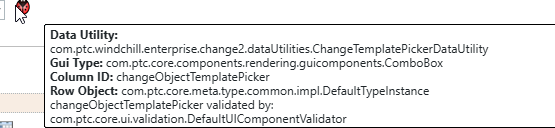

So we are clear, you are looking to have this drop down that selects the change notice template to default to a specific one based on some custom logic, correct? Where would be the source information for this decision maintained?
This is the information on that drop down:
This is setting the template for Change Notice, I want to update it for task that we receive from the workflow and not for the change notice.

You mentioned something about not having a complete button. Was this removed since in most templates, its there by default?  What is the larger goal here by wanting to choose different task form templates?
Even i thought that there was no reference of it the database and thereby we cannot customize it, I actually took the configuration approach of making multiple tasks. The larger goal is that the above workflow is being called from CR and CN in both the case primarybusinessObject will be different thereby the missing of complete buttons. I only needed those buttons so that  I can mark the task complete and proceed.
