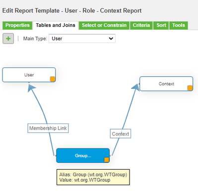

Given a User and a Role how to find it's context with API or DB query?
Thank you.
I think you're looking for something like this? Note that "group" is actually the Role assigned in a Context.
1 REPLY 1
