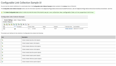

Currently i am exploring the Collective configurable link.  tha the is aviable in the ptc help center. I had doubt on it,

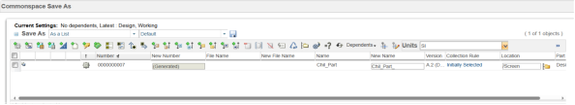

Thank you for taking over this case. I would like to give you a quick overview of the issue so we can continue smoothly.
We are facing a problem with the Configurable Link Collection features in a vanilla Windchill environment (no custom code involved). In the Save As UI and the  and in the Configurable Link Collector, the following default Windchill actions are not working as expected:
  • Collect related Describe child objects
  • Collect related Master child objects
  • Collect related Reference child objects
  • Collect related Revision child objects
  • Collect related Describe parent objects
  • Collect related Master parent objects
  • Collect related Reference parent objects
  • Collect related Revision parent objects
These icons/actions are part of standard Windchill functionality, but they are not behaving correctly.
