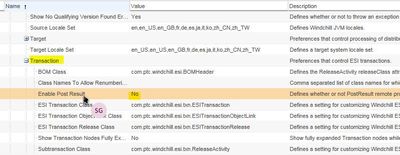

Whenever I initiate an ESI transaction in Windchill, the status is immediately getting updated as "Succeeded" instead of going to "Pending". If anyone can shed some light on this, it would be very helpful.

When the below preference is set to Yes, the transaction status will be automatically updated as Succeeded. Once it is set as No, the process is working fine.

What does the workflow show? Mine is pretty quick and I think if it gets to the end, its should be succeeded right?

Hello @avillanueva ,
Once a transaction is initiated, the expected case is to wait for the feedback from the downstream system. Now, instead of waiting for feedback, the RTM is taking Success path and closing the workflow.
