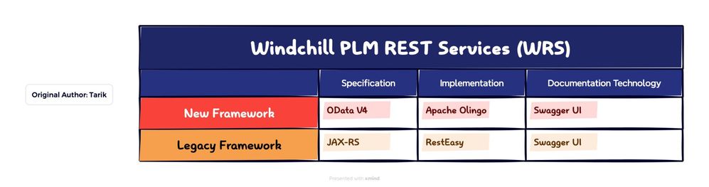

@SL_14436555  emm a lot of questions!
ESI
- Actually, REST APIs is the recommended approach for Enterprise System Integration and the only ESI approach for Windchill plus! Please use it for all new integrations.
Two Frameworks
- Windchill REST API has two frameworks; the old one is based on RESTEasy, and the new one is based on OData, while the old framework is still available...it's mandatory to use the new one (OData).
WRS releases vs Windchill releases
- Regarding your question that WRS releases are different from Windchill, it's no longer the case; starting from Windchill PLM 13.0.2.0, Windchill REST Services no longer has its own releases but follow the same release of Windchill PLM.
Historically, when PTC introduced its new REST framework based on OData, they chose to make a separate distinction between Windchill PLM releases and REST releases. Their strategy was explained as follows: because Windchill PLM releases are slow in comparison with CPS cadence (every 3 months in general) - CPS are only for bug and security issues fixes - but bring new features of OData REST. Now, they have changed this approach to return to what they were following for the old REST framework. Now, no WRS release, but its version is the same as the Windchill PLM release, but they continue to bring new features in REST in CPS streams, see: https://support.ptc.com/help/windchill/r13.0.2.0/en/Windchill_Help_Center/NewandChanged/NewandChanged_13_0_20_WRSWindchillIntegration.html#
I believe the new approach (matching releases) is more suitable for many reasons...
Doc
- Yes, WRS is documented using Swagger Technology:
Authentication
WRS supports almost all kinds of AuthN. The industry standard is to use SSO, so you may need to implement authentication through OAuth 2.0.
