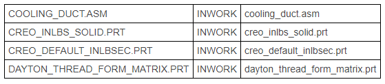

What the table should look like:
What actually shows up in the email message:
Email Source:
</p><table style="font-size:14px;border-collapse:collapse">
    <tbody><tr><td style="border:1px solid black;padding:5px">COOLING_DUCT.ASM</td>
    <td style="border:1px solid black;padding:5px">INWORK</td>
    <td style="border:1px solid black;padding:5px">cooling_duct.asm</td>
    <td style="border:1px solid black;padding:5px">CREO_INLBS_SOLID.PRT</td>
    <td style="border:1px solid black;padding:5px">creo_inlbs_solid.prt</td>
    <td style="border:1px solid black;padding:5px">CREO_DEFAULT_INLBSEC.PRT</td>
    <td style="border:1px solid black;padding:5px">creo_default_inlbsec.prt</td>
    <td style="border:1px solid black;padding:5px">DAYTON_THREAD_FORM_MATRIX.PRT</td>
    <td style="border:1px solid black;padding:5px">dayton_thread_form_matrix.prt</td>
</tr></tbody></table>
