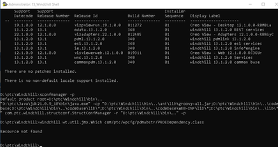

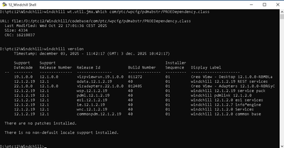

On the new server Windchill 12.1 and 13.2 is installed.
I tryed your action in the Windchill shell for both versions.
At windchill 12.1 the resource is found:
At Windchill 13 the resource is not found:
