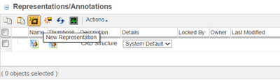

How to trigger this new representation option from outside of windchill or how we can call this action models in think Worx?

You could write own Windchill REST API function that can be called from the ThingWorx and based on your information you can send the object to visualization worker by Java API in the Windchill.
RestApi customization and Java class creation can cover your needs
