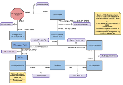

Actually,  I needed to fetch from wtobject directly the processes / tasks associated . Those tasks which are added in the workflow  not through change management
Preview
Finally saw this data model . It helped in digging deep in to the links.
After gettting the process details , we can fetch tasks, assignee etc
Here is the code (remaining portion i have attached in previous mail chain )
wt.query.QuerySpec qs11 = new wt.query.QuerySpec(wt.workflow.work.WfAssignedActivity.class);
qs11.appendWhere(
new wt.query.SearchCondition(wt.workflow.work.WfAssignedActivity.class, "parentProcessRef.key.id",
wt.query.SearchCondition.EQUAL, proc.getPersistInfo().getObjectIdentifier().getId()));
wt.fc.QueryResult activitiesinWfblock = wt.fc.PersistenceHelper.manager.find(qs11);
while (activitiesinWfblock.hasMoreElements()) {
wt.workflow.work.WfAssignedActivity activity = (wt.workflow.work.WfAssignedActivity) activitiesinWfblock
.nextElement();
System.out.println("Activity Details :" + activity.getName());
Enumeration<WfAssignment> enumAct = activity.getAssignments();
while (enumAct.hasMoreElements()) {
WfAssignment e = (WfAssignment) enumAct.nextElement();
System.out.println("Activity Roles" + e.getAssignee() + " " + e.getStatus());

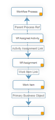

This is one way to get the info, using a report template:
The last link will be to whatever the Primary Business Object is for the Workflow
