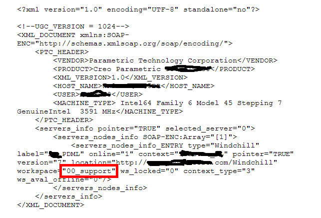

when a user opened a very huge top assembly by clicking master Simp Rep his workspace is often overloaded and can't be used anymore.
We wish us an ability to switch to another or new workspace BEFORE they launch Creo and log into WIndchill.
If the user overloaded his Workspace, he is normally not able to fix this by himself.
We from Support side can fix this by patching the active_server_config.fld to an existing emptx workspace.
Now the user is able to launch Creo with Windchill and can delete afterwards the overloaded Workspace.
But that needs extra support resources and could be done by the user if he would get an choise to do.
