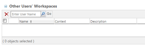

I noticed this today on my homepage when logged in as an administrator:
The functionality we're looking for is almost there.  I did a quick search and all the user's workspaces were visible.
Unfortunately the only thing you can do with them is delete them.

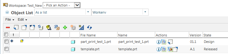

I also tried directly copying the URL for a workspace when logged on as a user to a different session logged on as a administrator.  While this does show the workspace, it doesn't show uploaded, but not checked in objects.
User's view (from stand-alone browser):
Administrator's view (from stand alone browser):
So technically an administrator CAN get to a user's workspace, they just can't see new or uploaded objects that haven't been checked in yet.
