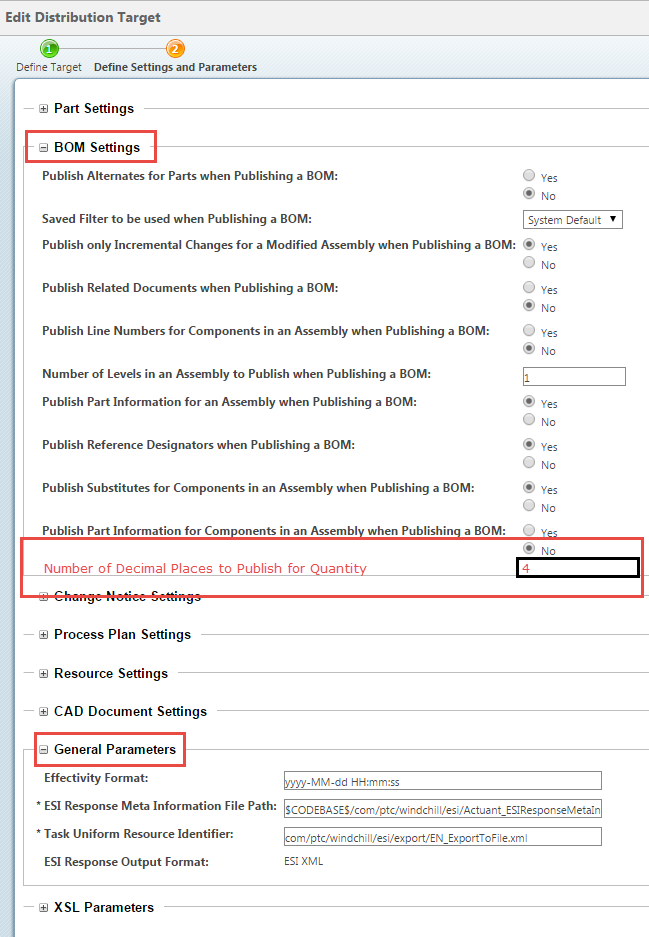

For a specific BOM I have an esi failure: Job-95961 Error in [ProcessDefinitions/ERPCommunication/SAP/BOM/Start_CBOBOM_SAPCreate_PD.process/Invoke_BAPI_MATERIAL_BOM_GROUP_CREATEServer] Input data invalid ,
but I can't understand which is the data input invalid and why.
With a simple check the system can tell to me that a quantity in a bom has 4 decimal numbers (1.3072) and that it is not valid!

BenPerry
Nicola Giacomelli‌,
I'm just looking from the outside.  I'm not sure about the details.  But perhaps your situation can be flagged by implementing the use of Windchill Business Rules prior to release to ERP?  I also haven't implemented them myself, so I'm not sure if they can be leveraged to flag quantities with a certain amount of decimal places (for example 1.3072).
I also wonder if you can add a constraint to the quantity on the WTPartUsageLink - a regular expression constraint - that can mitigate the issue from the start?
syadala
Yes Business rules work. or alternatively you can write a custom BOMComponentRenderer and trim the quantity as per the requirement.

syadala
We have achieved the functionality in Business rules and BOMComponentRenderer. Where as Business rules will make the user to update the Quantity the Renderer simply trims the additional fractions. The users liked the Renderer as it is faster way to send data to ERP. I would like this as preference on distribution target as we can have multiple targets and the precision can vary.
BenPerry
Sudhakar Yadala,
I think you nailed it - add this into the DT settings, as shown in the screenshot below.  Maybe under BOM Settings - or maybe under General Parameters.  Not sure where it makes the best sense.  I think that would be the easiest method for PTC to implement this product idea.
But Nicola Giacomelli, I don't want to hijack your product idea.  Do you agree with it?  Or are you looking for something else?
ngiacom
I agree!
