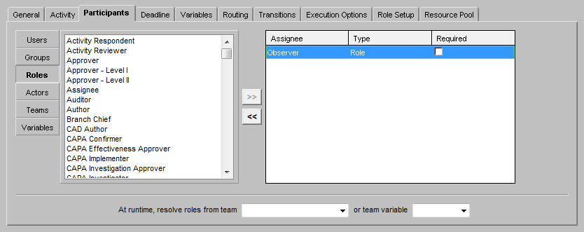

Today most out of the box workflows include a reviewer/approver and an observer task.
The observer task usually is set to a non-required participant.
However if you have multiple users in this role it will close out on the first completion, leaving the others with no ability to respond.

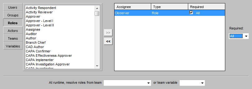

If the vote is required, you can set it to complete on All, Any, or Number. However this is not possible for optional.
I'm proposing the any, all, number selection be independent of the required check-box allowing multiple optional observers.
