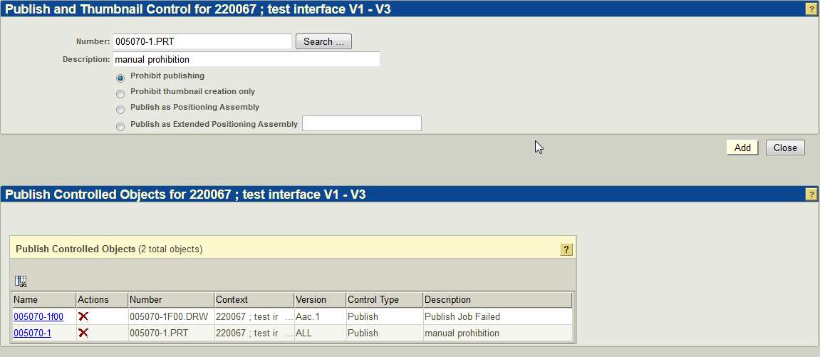

In the "Publish and thumbnail control" UI one can only prohibit publishing for ALL versions of a CAD document.
However if one use the following property in wvs.properties :
publish.service.addprohibitiononpublishfailure.0.0=true
then the prohibition is defined only for a specific version.
Given the stability of the WVS the property can hardly be used without prohibiting too much publications.
So the UI is definitely missing the possibility to choose if only a specific version or all version should be prohibited from being published.
