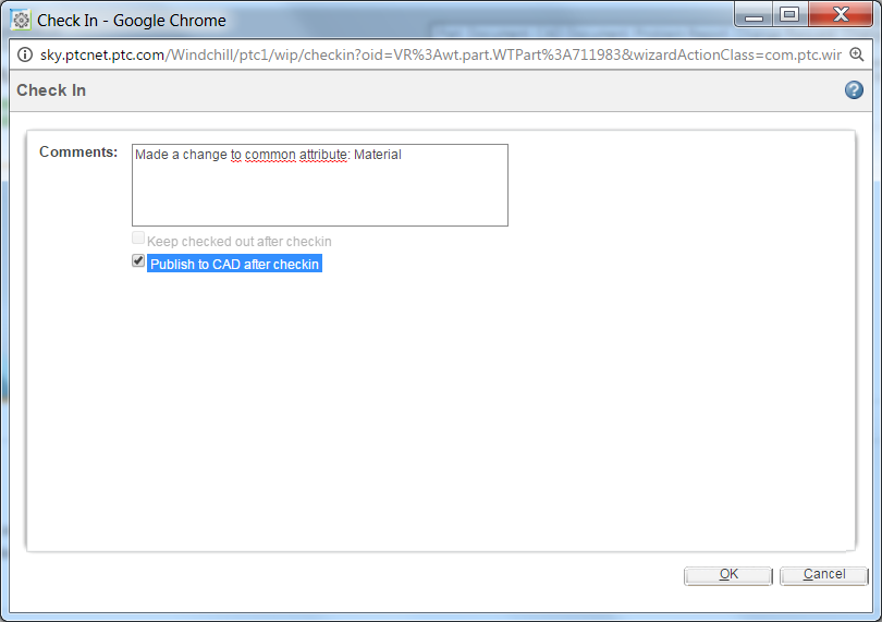

Not sure if this would address your concern; but you can automatically "Build" after either the Part or the CAD Document changes.
For CAD Documents, you are familar with the default behavior to Build the related Part after check in.
In Windchill 11.0, you can also automatically build the CAD Doc after Part check in.
  • You can set the server-side preference Part Management > Publish to CAD after Check In to Yes (by default it is No (the old behavior))
  • The preference above controls the behavior in the Part check in UI:
  • If this is checked, then the system will update the built attributes (and valid structure changes) on the CAD Document.

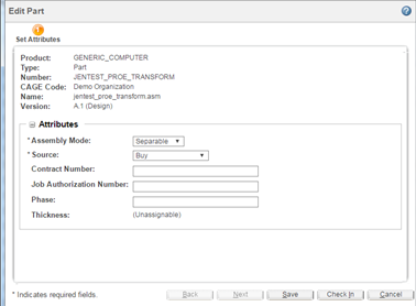

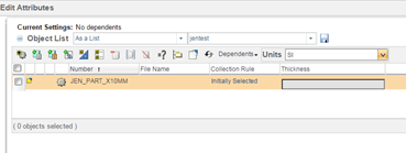

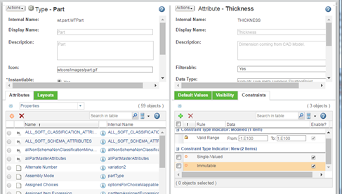

- For CAD to WTPart ONLY (e.g. the Creo designated dimensions), you can do this out of the box using soft-type constraints, right?
  • Add the global attribute to both CAD Doc and Part soft type.
  • CAD Doc you can use the default constraints
  • For Part, you need to modify the constraints to be immutable
  • Then Windchill UIs will prevent their modification for Parts only:

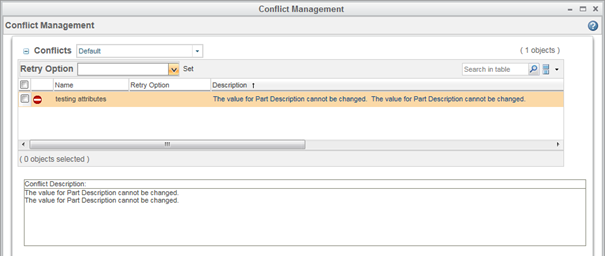

    • ** Note:  Good or bad, the build service will not honor this constraint and will continue to update the attribute.

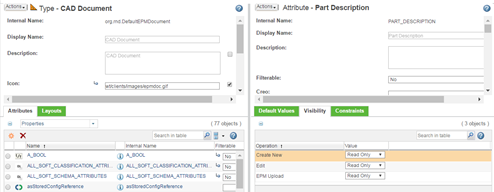

- For Part to CAD:
  • Part you can use the default constraints
  • For CAD Document, you need to modify;
    • the constraints to be immutable
    • The visibility to be Read Only for all fields
  • This should give you the result that:
    • Windchill UIs don't allow edit
    • Creo cannot upload
  • Additionally, to push the WTPart attribute changes to the CAD Doc, you would need to build after Part check in (original post)
  • ** Note:  Good or bad, the build service will not honor this constraint on the CAD Doc and will continue to update the attribute.
