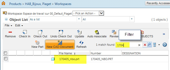

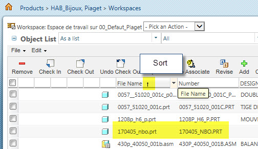

It would be useful to be able to change the 4 defined rules of the “relevant” list.
Newly integrated objects are not visible if the filter is defined to "As a Featured Objects list”

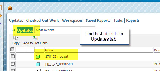

Of course, it is always possible to filter, sort, pass by the tab "Updates" but it would be more efficient if the "automatic relevant" filter could follow our way of working.
