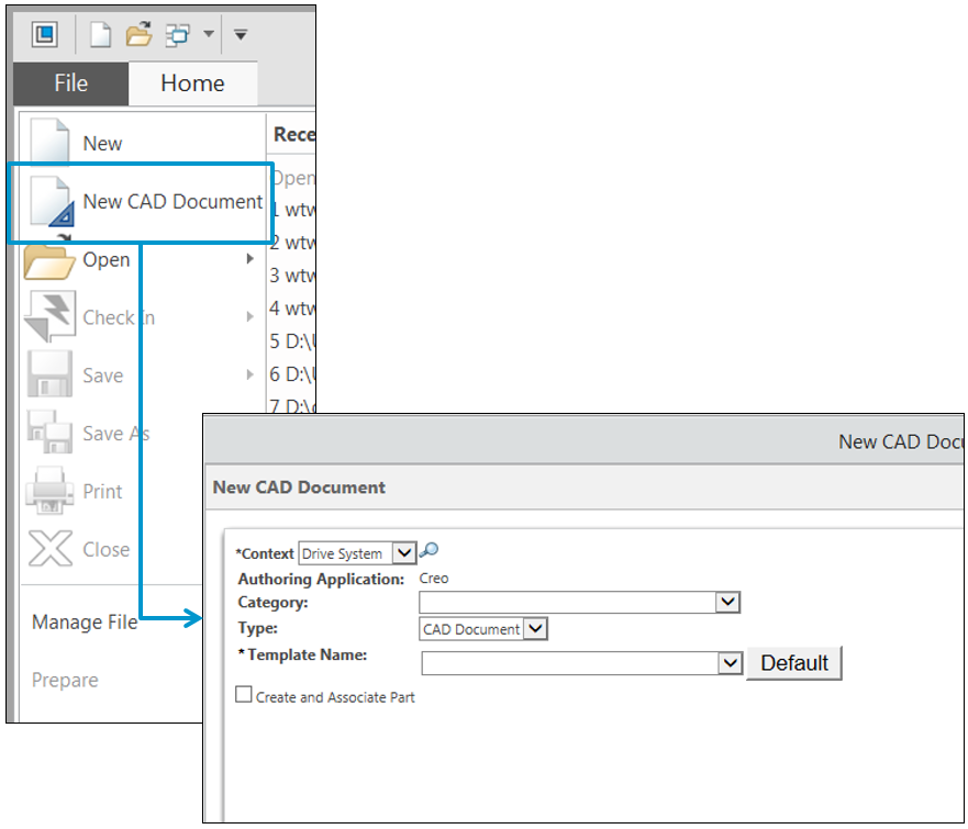

SteveShaw
Bjoern,
In Creo 4.0 we have plans to introduce the Create CAD Document UI to be accessible directly from the Creo File menu...

Steve Shaw‌, while that may be helpful for some, it would be much better to simply align the terminology in Creo with that used in Windchill.
This picture is from Improve consistancy between Creo and Windchill.

SteveShaw
No disagreement here.  It is something that is on our backlog as well.  However, the Create CAD document does have the benefit of allowing users directly in Creo to set additional Windchill attributes and security labels (if configured) during the create process.
bmr
‌HI Steve
thanks for the screenshot. But why do you have still the old create dialog available? Is it possible to hide it complete from the UI? For me it makes absolut no sense to have both dialogs. If you're connected to Windchill you don't need the old dialog anymore...
TomU
23-Emerald II
I agree that having both dialogs seems redundant.**  While the new dialog may be helpful for certain companies, I don't see us ever using it. We never create new cad files directly from Windchill, we only do this from Creo.  There is also no correlation between the Creo template paths and where Windchill stores its templates.  (I could be wrong, but I don't think Creo can even see the Windchill administrative location for templates...)  For those companies who are more Windchill centric or using Windchill to create structure, this new dialog might make sense, but for those who are CAD centric and simply use Windchill to store and manage their CAD data, this new dialog probably isn't going to be very useful.
I don't really care if the new one is added, but I still think the old one should be changed to keep the terminology consistent.
As an aside, from the picture above this looks like a web browser dialog which probably also means that it won't work with mapkeys.
Edit:  ** Yes, create the new dialog if you want, but please give us a config option to hide it and also fix the old dialog to match terminology.

sorry this looks imho like some kind of disimprovement. You give users the opportunity to click the false icon. There must be a chance to hide the traditional create new part window or get rid of it completely (just throw it in the bin this looks so old fashioned). Before you managed to break away old customs you start a proper creo integration of the create new windchill managed cad part. (e.g. replace by copy in assembly a.s.o.)
bmr
Sorry Steve, but this solution is just ridiculous. You can not say that PTC is a PLM (or whatever) company and still thinks that both world native and PDM works together. Bring a solution for PDM and make it switchable to nativ for standalone Creo.
But as we already talked in this community, the focus from PTC is probably wether Creo nor Windchill at the moment... And that's the result.
