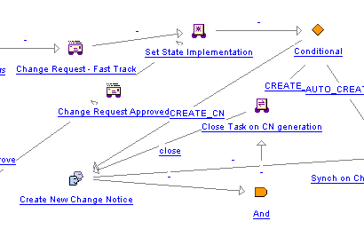

Today we already skip this step if a CN exists.  If desired you can add a Sync Robot today to look for the creation of a Related CN and as a result have it close out existing Task if the new CN is created.  Here is a quick example I created:
There is a new Sync Robot - Close Task on CN generation that listens for CN creation.  It tests to see if the CR then has a CN linked to it.  If so it fires the Close route which Terminates the Create New Change Notice Task.  I also added a link from the Create New Change Notice Task that terminates the Sync robot if the user happens to select Complete Task

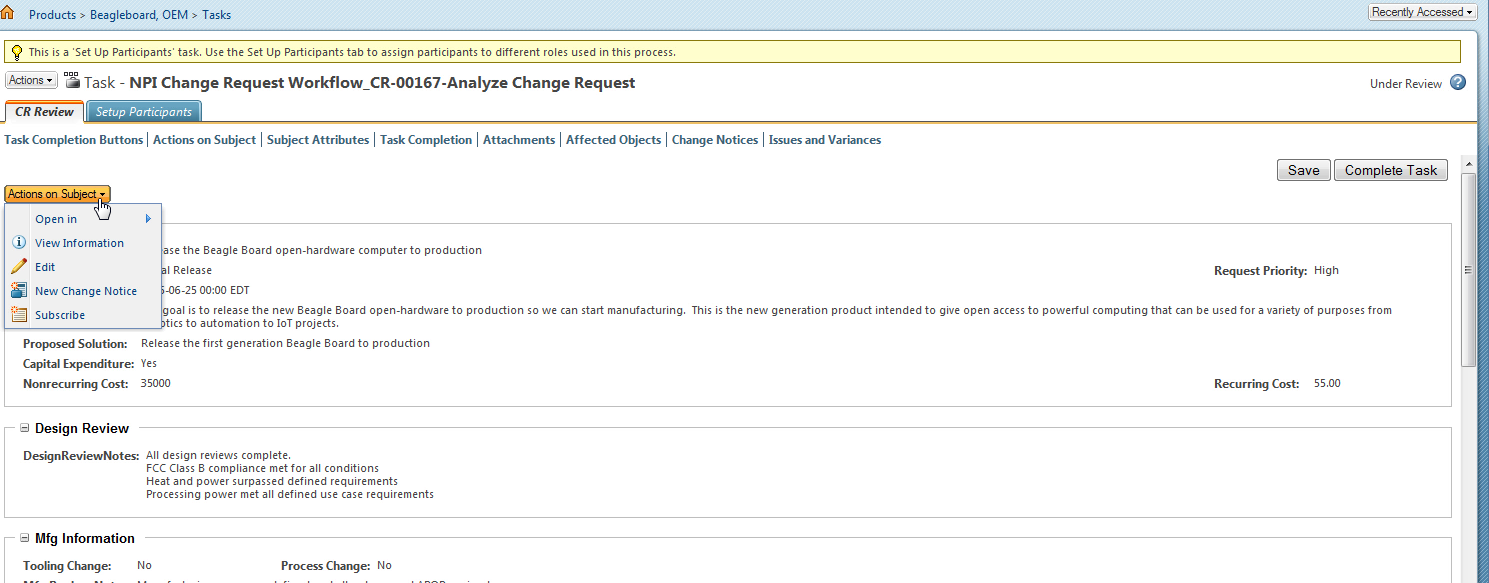

Also with 10.2 M030 with the Native Task Templates one can add Attributes, Actions and Tables to Workflow Tasks from the PBO.  In this case one could add the Create actions from the CR to leverage the normal create process from within the Change Task process then the user could hit task complete.   Notice in the example below in the Workflow Activity the user can Edit the Change Request, create a new Change Notice, Subscribe, etc.  Also shown are some attribute groups from the Change Request, Attachments, Affected Objects and some related Changes tables.   Further - as I noted above an admin could add a sync robot to listen for the CN creation and close the task automagically.
