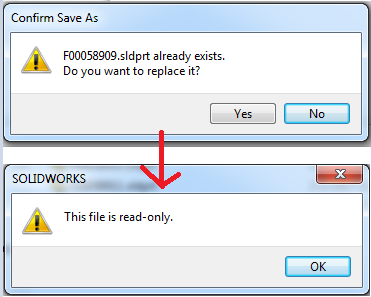

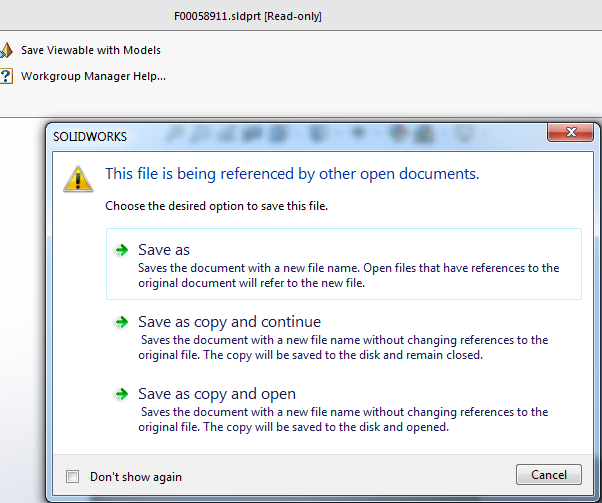

For SolidWorks it says [Read-only] in the header next to the filename. Nothing prevents the user from modifying it in session.
When they attempt to save it, it pops up the window below if referenced by other objects. Otherwise it just pops up the Windows Save dialog. If Save as is chosen, again the Windows Save dialog appears.
In the Save dialog: If they try to save it as the same filename (save over it) it blocks them, stating the file is read-only.
