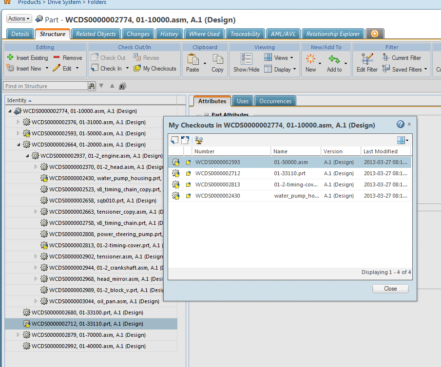

This can be accomplished today from the PSB.  If all your check outs are in on product structure you can use this method.  The My Checkouts will find all of your checked out parts in the structure and allow you to check them all in from one location.  You can add check in comments and do all at once, or one-by-one.  You can also Undo Check out from here as well.

Yes, I know you can use this, but then all the parts need to be in the same product. If not, you can't use this....
