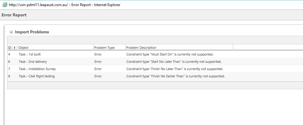

Could ProjectLink be ammended to support all MSProject "Contraint Types"
ProjectLink is severely limited in the MSProject "Constraint Types" it supports. This is a serious shortcoming as constraints are key to scheduling.Unsupported Constraints.JPG
4 Comments
CaitlinWheeless
1-Newbie
What version of Windchill are you using? These constraint types were added to ProjectLink in 10.2 M020. Per the help center, they are compatible with Microsoft Project:
http://support.ptc.com/cs/help/windchill_hc/wc102_hc/index.jspx?id=ProjMgmtConstraints&action=show
HermanHaasbroek
Hi
The PTC help center info is misleading. They do not support all the constraint types, see quote form PTC support below dated 06 July 2016
"Just have double confirmed the possibility of CPS patch request with the business impact, but unfortunately these constraint types are not supported in ProjectLink. Supporting these will be an enhancement that cannot be done through CPS.
- Constraint type "Must Start On"
- Constraint type "Start No Later Than
- Constraint type "Finish No Later Than
- Constraint type "Finish No Earlier Than"
