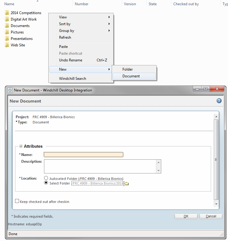

As of now in Windchill 10.2 M020 :
It is possible to created document from template through Office Integration and Windchill UI.
But the same functionality is unable through the Windchill Desktop Integration.
However we can drag and drop the document for creating new Document or create a new Document but cant cant attach a primary content to it.But customers will be having Predefined templates on which they are supposed to work on .and It is important to enable this functionality in the user perspective.

Just to clarify, PTC Windchill supports creating a new Windchill document from a document template using the browser interface and Microsoft Office. The only way to initiate the new document interface without drag-n-drop in Windows Explorer is with the Right Mouse Button (RMB) option, New > Document.
You're request is to add "From Template" to the Windows Explorer RMB New > Document action?

Hi Scott Morris,
Yes, You are right We don't have the option to create new Document from template wherein Document is downloaded from the server during the creation.

Scott Morris‌,
Anything further on this?  I am running into this right now.  Users are looking to start using DTI.  But they need to create documents from templates.  Therefore they must go into the browser to create the new document from the template, and then afterward, they can download it and start using DTI as normal.  Seems like a disconnect.
Are we really unable to "Create Document from Template" in DTI?  FYI...I'm using 10.2 M030.  I get the same screenshot you posted above.  There is no drop-down menu for "Template".

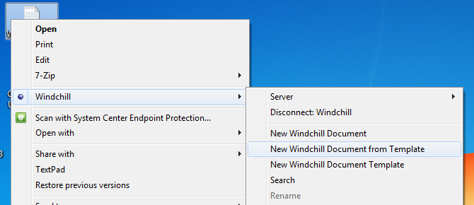

Right now, there are 2 ways to create documents from a template using DTI:
If the template is Microsoft Word/Excel/PowerPoint, you can do it from the Windchill menu added to the ribbon.
For example:
  1. Open up a blank document in Microsoft Word
  2. Select Windchill > New > New Document from Template
  3. Select the Windchill context/folder (this will create a document object in the location you choose and check it out to you)
  4. Select the template and fill out whatever other required attributes there are. Click Finish.
  5. The template downloads and opens in Word.
  6. Make your changes, and then select Check In from the Windchill tab in the ribbon
If the template is in another format (PDF, TXT, XML)
  1. Ensure you have the Windchill context menu enabled (done through the configuration menu)
  2. Right-click any non-MS Office file
  3. Select Windchill >  New Document from Template
  4. Follow the same procedure above. However, when you're done, you'll need to take an extra step to check in the document to Windchill. The easiest way to do this is to open up Windows explorer, navigate to the context under the Windchill Documents node, right-click the document, and check it in. It will automatically upload the working copy of the file saved in your local cache.
