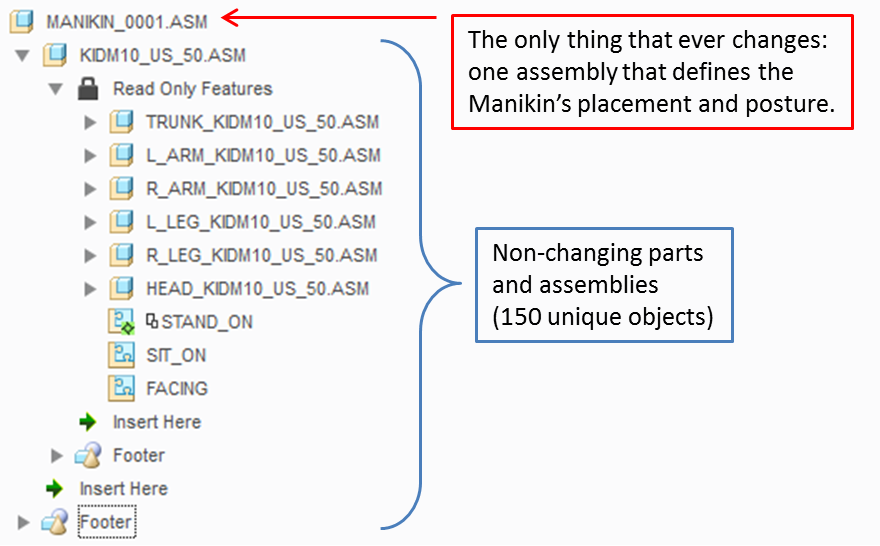

Creo Manikins are currently controlled by Digital Rights Management (CS60429).  This prevents the CAD worker from being allowed to open and publish the individual components for use within positioning or extended positioning assemblies.
Please either:
A.)  Allow the CAD worker to override DRM so positioning assemblies will work correctly with Manikins
or
B.)  Adjust the behavior of the CAD worker so it will automatically publish all Manikin assemblies and Manikin controlling assemblies (created from MANIKIN_PLACEHOLDER_TEMPLATE.ASM) as full geometry representations (non-positioning).
