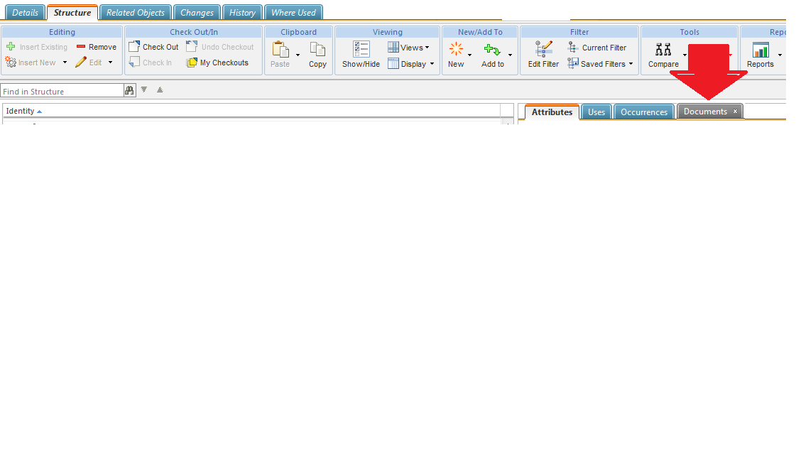

The Product Structure Browser (PSB), found on the "Product Structure" tab of any WTPart property page should have a "Documentation Subtab" similar to the PSE by default.  THis should allow the documents associated to each part in the assembly to be shown without opening a new "Information" page for each object and thne going to the Documentation Tab.

You can show associated documents to the WTParts right in the PSB Structure tab.  Would this not do the job?

I second Jim's response above.  There are actually 2 discussion points here.
  • Document tab shown in the screenshot can be created by an admin, and shared.
  • If your "documents" are associated to the WTParts, in an upcoming release of Windchill there will preferences that allow the ability to show or hide the associated documents by default, instead of having to manually Show/Hide them.

This is something we have plans to support in a future release.  In addition to the show/hide improvements we are looking at, the ability to just access a specific set of documents without having to show is important.
JeffZemsky
As part of the applet retirement projects this is being worked on for the next release

The Document tab was added in PSB in Windchill 11.0 M030.  It supports Describes, Reference and CAD Documents

The Document tab was added in PSB in Windchill 11.0 M030.  It supports Describes, Reference and CAD Documents.  Here is an example:
We are hoping to add support for Configurable Link Tables in the June 2019 release.
