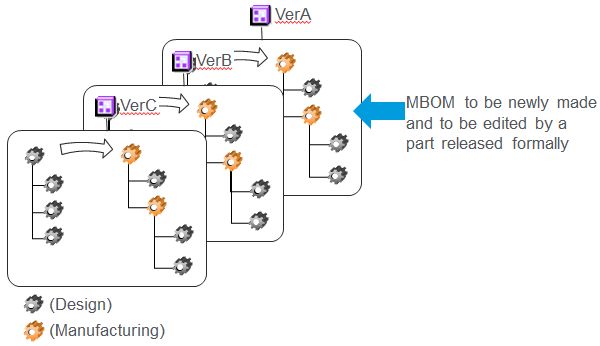

[Description]
Ability to edit MBOM(Downstream) by using only non-latest parts that are in baseline configuration of EBOM (Upstream).
[Use case]
EBOM creates a baseline when its released and stores it as released configuration.
EBOM has multiple releases when its revised to keep/manage them as baseline configurations.
MBOM consists of EBOM config parts that are correspond to each release.
MBOM might not be created with EBOM therefore, to create MBOM that corresponds to formally released EBOM, MBOM should be edited within a part of EBOM baseline configuration.
[Problem with current functionality]
With currently available functionality(PSE, MPSE,PSB), BOM editing is done for only for the latest part.
Formally released MBOM cannot be edited directly by using config part of formally released EBOM.
Formally released MBOM configuration can be shown by baseline based display control(Filter) but the following issue still exists:
MBOMDownstreamand baseline need to be edited in parallel which makes operation so complex.

GregoryPERASSO
I'm totally agree with your business case.
And it is the right way to work with xBOMs. As the equivalence link between the EBOM and MBOM is "Context" filter aware. An Ebom release is valid for a mBOM release
But I don't think baselines are the "correct object" to use in your case. As baselines are "static" photography of your xBOMs. ie a baseline stores a specific iteration of the WTpart. And is more used to store a particular state . But not to work in ...
You should be able to do exactly that you want by using "effectivities" (date, lot, serial number etc ...) which is another type of BOM filter. But contrary to Baselines, is more "dynamic"
and do as in your screeshot:
eBOM (lot 1)->mBom (lot 1)
eBOM (lot 2)->mBom (lot 2)
you will be able to work concurently , at the same time on several lot (ie different release of your xBOMs)
And when a lot is fully released (eBOM and mBOM) you can still store is by populating a baseline with the filter lot1 , and then lot 2 ...

GregoryPERASSO
Dear Tsuyoshi,
as a baseline store a particular iteration of the WTPart. it is not realy easy to update it during a "work in progress" phase.
It is more used to store "static mile stones" of your BOM.
For example a "photography" of your BOM for the prototype 1 , prototype 2 ... or to store the BOM state in a particular phase of your project.
You will be able to visulaize, your product as it was in this milestone . Or compare Proto 1 and Proto 2. Or proto 1 with Latest BOM ...
Effectivities are "version" based. (not iteration), so you are able to work with , and not manually maintain them , even if your WTparts iterates (checkout/in) ....
You will , as for baseline, be able to visualize or compare, lot 1 with lot 2, etc ...
regards
Gregory

Dear Gregory,
I understand what you want to say.
In our thought,
Effectivity and Baseline are same as the the function which control Filter.
When we edit MBOM(Downstream), we need to take care Effectivity or Baseline which drive Filter in parallel.
For example, How about the case to add Phantom Part to MBOM.
Evev if we use Effectivity, we edit MBOM and need to set lot numbers to each related parts in parallel.
We think those situations are complex.
Our focus is "Easy to edit".
I think our idea and your idea fill the gap with each other and isn't conflict.
It is good if both ideas are implemented.

GregoryPERASSO
Phantom Parts is a particular case. As they are not "real" parts (no stocks, no process plan, not consumable ..) It is only organisational nodes in the BOM. So to my thought , they should inherit the effectivity (baseline, lot , etc ... ) of their parent WTPart.
GregoryPERASSO
Dear Tsuyoshi,
If I understand your screenshots , you want to store the eBOM and mBOM in the same baseline (to keep the "equivalence" of the 2 BOMs)
But a baseline can store only a single version (ie View) of a WTpart. So it will work only in case of a "new downstream part" , but not in case "new view version"
regards
