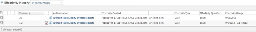

  4. Set effectivity with Effectivity Context (Context of itself) , Date Effectivity, Qualifier = Exact, Effectivity Range= 9/15/2013 -
  6. Revise the CN, For Impact select Revise
  7. Change the effectivity on resulting part (rev2) With Effectivity Context (Context of itself) , Date Effectivity, Qualifier = Exact, Effectivity Range= 09/25/2013
  8. Release CN, Notice the Effectivity has NOT been updated. Effectivity should be updated to the new Range, 9/25/2013

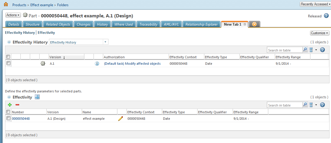

This has worked for some time.  It appears that there was some misconfiguration and user issu above. In the example above it looks like the user type 9/15/2013 for version 2 as it closed the range on 9/15/2013.  Note that Sibling Propagation = Yes must be set to automatically close the previous revision range. Example posted below:
Effectivity for Rev A set to 9/1/2014-
And now with second CN, revise and set Effectivity to 9/25/2014-
