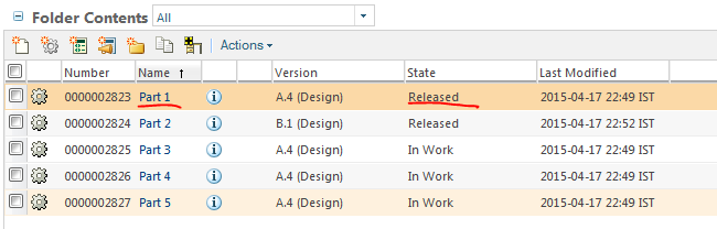

I have the following objects:
Part 1:
Versions A.1, A.2, A.3 = In Work
Version A.4 = Released
Part 2:
Versions A.1, A.2, A.3, A.4 = In Work
Version B.1 = Released

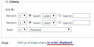

I searched for parts that are in the latest iteration and in the In Work state, and got the following results:
Note that Part 1 version A.3 was NOT included in the results, which is what the original post seems to be addressing.
Whether or not Part 2 appears is set using the "Latest Version Search" preference -- but that is dealing with revisions, not iterations.
(And technically, specifying latest iteration is unnecessary. By default, all searches are performed against the latest iteration. The Iteration criteria is only necessary if you're searching for a non-latest iteration.)

I wish the search criteria were applied in the order defined.  This would solve the problem of not being able to locate the actual latest version and bring so much more capability to the search tool.

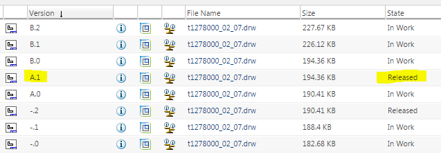

Looking at the history of the two objects, this is what I have:
Performing a keyword search gives me the latest version of both of these objects:
NOTE: The search results are what I would expect based on my current preferences of returning only latest versions of objects.  Object 1, therefore, is returning the C.2 Production version into my current search results window.
When I apply a facet to "Refine Results" as indicated, I would expect that to only apply values based on what was originally returned in the search results window.  So clearly, if I said, refine the results to show me objects that are currently at the state of "Prototype", there is only one object in my current search results window that meets this criteria, which is clearly Object 2.  However, here is what I actually get:
Instead of "refining" the results, it has (in effect) restarted my search all over again, looking through the history of the objects, to find a match to the criteria, and therefore has given me the A.3 version of Object 1, which was the latest revision/iteration that was at Prototype.
Perhaps we need a facet checkbox option or preference to ignore older versions, or have that be the default action, and a checkbox/preference to "include older versions" that would then behave this way for those that want it.
