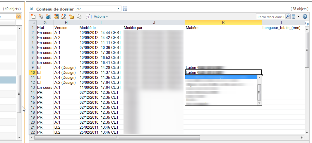

Implement advanced and consistent mass update capabilities that can be used from any type of container or display (folder, workspace, search result, managed collection, clipboard). The user should have only to select the objects to be modified and the table to be display without to add to workspace, copy or whatever.
Use case :
As a product manager the marketing asked my to change the color of all articles of our new collection from blue to light blue. After a search in the new product lines context, I select all articles and turn to update mode to modify color like I would do in Excel.2012-11-09_08h41_49.png

Have you considered doing this in Search?  You can search on multiple Part Numbers for example (; as a separator) and then do a Multiple Edit from the Search Results.  Would this meet the need?
GregoryPERASSO
Hi Jeff
the idea is more about "usability" with excel like features.  (Column drags etc ...)
Will the nice to have this kind of ergonomic features in PSB and  all strcuture Views
regards
Gregory
JeffZemsky
Thanks - that is good clarification.  some editing use cases -
  1. Pick many and change at once (already supported)
  2. Drag update (Excel like) (Drag and increment; Drag 1 value (ctrl-drag in Excel))
Are there others?
GregoryPERASSO
Copy/paste from Excel
may be not ...  sounds like the export/import from Excel
but at least having drop down list for Enumerated List attributes.
And in PSB for WTpart attributes.  Today it is only Usage Link attributes.  And really painfull to open a BOM in the PSB, and then having to update each Wtpart one by one ....
