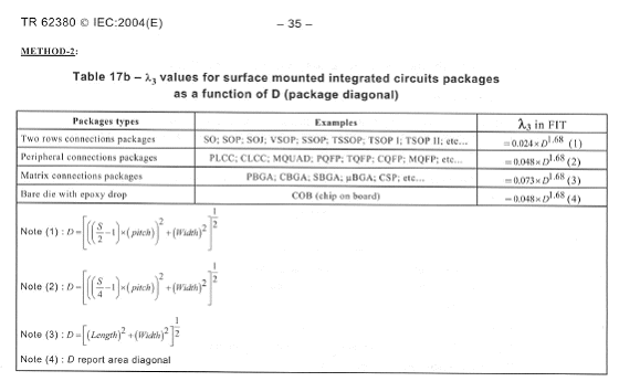

IEC62380 The package diagonal calculation.
IEC62380 prediction
BICMOS Integrated Circuit(silicon)
The default data of the package diagonal is zero.
We have to calculate the package diagonal by the following info and the calculation formula manually.
S: Pin number
Pitch[mm]
Width[mm]
Length[mm]
We think that WQS should have the above fields to be calculated automatically.
Can you add the above fields into WQS ?
Thank you.
