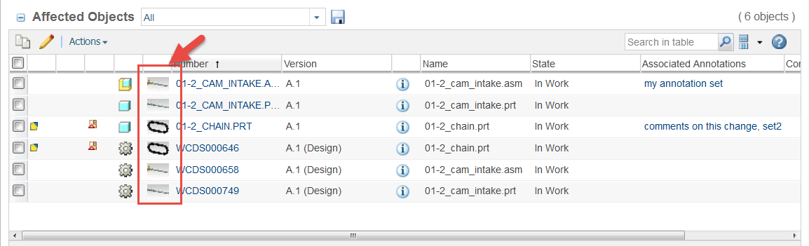

With 10.2 M030 we added the Native Task Templates which allows you to configure the Affected/Resulting/Change Summary and other tables right into your Workflow Activities reducing the need to navigate away from your Workflow Activity to get your work done. (You can also add PBO attributes, actions and other tables purely through configuration)
1) Thumbnails are available to configure into Affected, Resulting and Change Summary tables with 11.0 M020.  Note you have to configure them into your Info Page Table views as we cannot update views in an MOR
2. While we cannot yet multi-select to launch to a single CreoView session we can launch multiple to a session one at a time.
