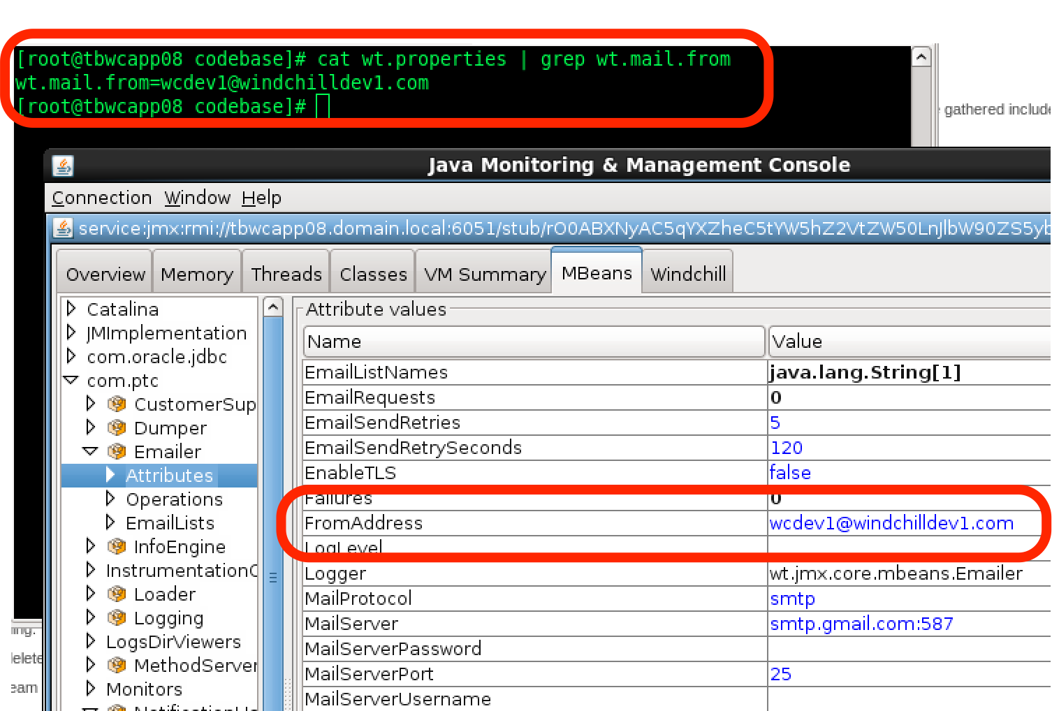

To distinguish the emails coming from different servers, you can set the from email address at both wt.properties and JMX. This works only if your exchange servers is set to allow emails from different email ids other than the one which is used to authenticate against.
