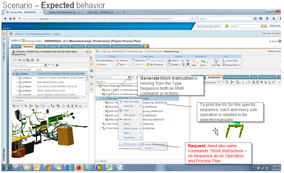

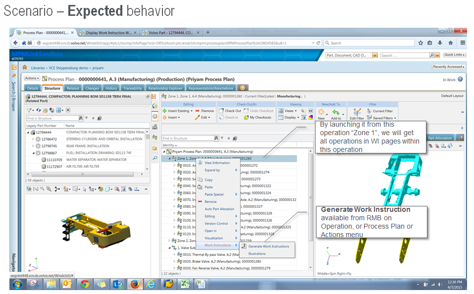

Context: MPMLink, Process Plans, and generations of Work Instructions for the shop floor
Issue: It is not possible to generate work instructions for a sequence, and hence when needed to print these, one would need to either.
1) Print out complete process plan and discard all not needed information
2) Manually select operation by operation within this sequence for printout. If the Sequence contains quite many Operations (which is common), this is not user friendly, time consuming and error prone.
Request: Add support for generation of Work Instructions on sequences, (same as Operation and Process Plan)
